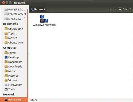

  5. Why Computer2 is not getting shown on my network connection in Computer1 ?(without using connect to server option) why my linux system is not shwoing in this? Screenshot of Nautilus

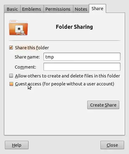

You can allow shares without password. There are many things to say about this, but probably this Nautilus screenshot helps for the beginning:

5. Why is the server not showing up in Nautilus / Network on the client?
As far as I know, the first time it doesn't show up there. After connecting to it once, you'll find it there. The first time, you will have to click "Windows Network", then "Workgroup" and then you'll see your server - hopefully. At least this was the result of my tests.
