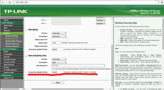

I was with the same problem. Here how i resolve the problem: https://ubuntuforums.org/showthread.php?t=2261225
Go to your modem wifi security settings.
If WPA/WPA2 Group Key Update Period is zero or disabled, you must change it.
Set WPA/WPA2 Group Key Update Period to 86400 as shown in the screenshot.
Save your settings and reboot your modem/router.
