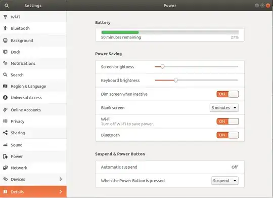

Option 3
  • Go to settings
  • Choose Power
  • At the bottom, choose for the value Suspend for the When the Power Button is pressed
Now you can just click the power button to suspend.

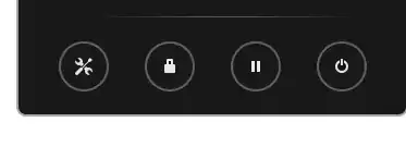

There isn't any, Welcome to GNOME!
But like in most of the other cases there's an extension which adds one: Suspend Button. It
Allows to modify the suspend/shutdown button in the status menu.
(screenshot source: extension's homepage at extensions.gnome.org)
Alternatively, if you press alt, the power button should change to the suspend ("pause" symbol) button.

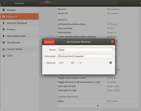

You can add a keyboard shortcut for suspend action like below:
  1. Go to settings -> keyboard
  2. Click on + sign at the bottom of page to set a custom shortcut
  3. Enter shortcut name as Sleep and command as /bin/systemctl suspend
  4. Now click on set shortcut button and set a keyboard shortcut
screenshot
