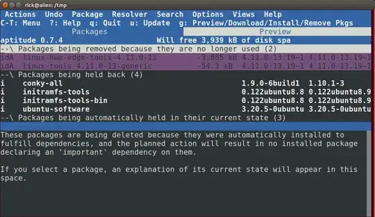

As per comments I gave aptitude-build-state-bundle and aptitude-run-state-bundle a try after installing programs using:
sudo apt install aptitude-common
Running the build program resulted in a whopping 334 MB file compressed to 92 MB.
Transferring the compressed file to the target laptop and running aptitude-run-state-bundle gave this colorful screen (among many):
We can see it's tracking held packages! The old laptop was running kernel 4.4 and the new laptop defaulted to 4.10. I deviated from the unwritten rule of copying and pasting text screens and used color snapshot because it's easier to digest.
This is about as far as I got because an on-line tutorial for aptitude-run-state-bundle hasn't been located yet.

Selecting packages from source machine and installing them on target machine didn't bring over conky which was held back to version 1.9. Other software like unity-tweak-tool didn't reinstall either.
