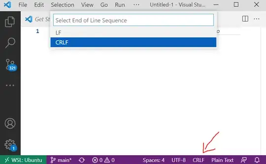

10
I was using VS code within my WSL environment to edit the bash script. Changing the setting from "CRLF" to "LF" on the bottom right corner fixed it for me.
VSCode window
