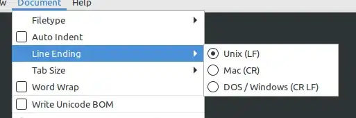

Configure your editor so it uses Linux format for saving files (If it's capable of) or use an editor in bash like nano:
