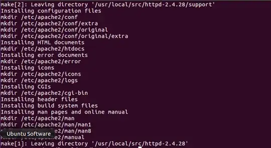

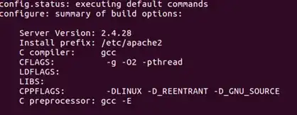

    ./configure --prefix=/etc/apache2 --enable-mods-shared="reallyall" --enable-mpms-shared="all"
    Configure result
    make && make install
    ln -s /etc/apache2/bin/apachectl /etc/init.d/apache
    update-rc.d apache defaults----> It has this warning "insserv: warning: script 'apache' missing LSB tags and overrides"
    service apache start

@Edit: as the comment I change:
to
./configure --prefix=/usr/local/apache2 --enable-mods-shared="reallyall" --enable-mpms-shared="all"
Please help me, thank in advance.
I believe you have done several things wrong. First this line:
should have been:
./configure --prefix=/usr/local/apache2" --enable-mods-shared="reallyall" --enable-mpms-shared="all"
Your --prefix option during compile is wrong. I advice you remove it and fix that --prefix option
