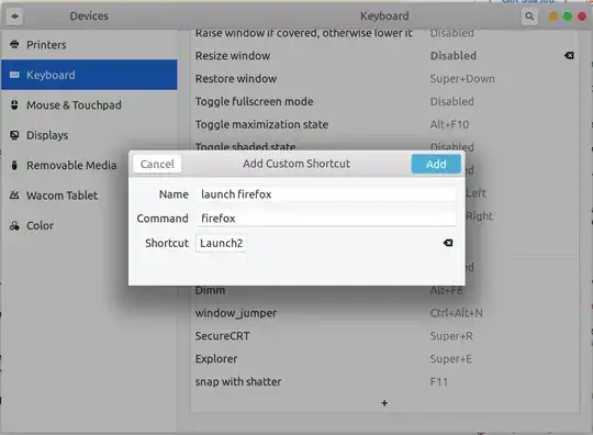

Now you can map the XF86Launchx to any action by using the keyboard shortcuts:
You can create an entry in rc.local so these scripts are executed automatically when machine boot up.
