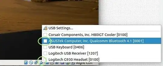

  1. Right click your USB Devices on VirtualBox (Not inside Windows 10, but on the VirtualBox bar below it) and Enable the Bluetooth device detected by VirtualBox. At this point, if you follow everything and the bluetooth does not show, on some cases it is because it can't be in use before sharing it with VirtualBox.

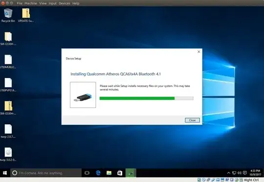

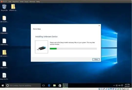

  2. Windows will not try to install the proper drivers for it. If the drivers are not found, I suggest going to the companies website and downloading the drivers through Windows 10 and then proceeding on installing them manually.

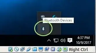

  3. After installation click on the Bluetooth Device Manager to Pair your Windows 10 with a real device:
  4. Click on the Device found that you wish to pair and then click on the Pair button that will show.
