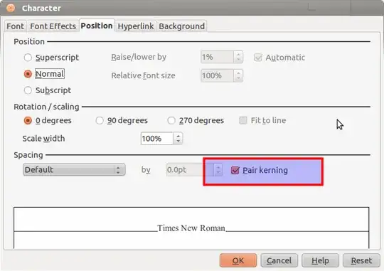

Kerning is activated by using the Format->Character menu, selecting the Position tab and using the Pair kerning checkbox in the Spacing section.
Jorge Castro
  • 73,717
Do a "Select All" before you turn kerning on. Otherwise it will apply only to a local selection, possible the current paragraph.
(I am using up to date libreoffice on a Mac, but this should still apply.)
