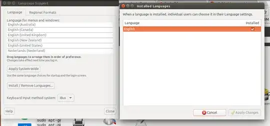

In my Ubuntu I went to System Settings > Language support -> Install/Remove Languages and I just get English.
I tried sudo apt-get install language-pack-fr language-pack-gnome-fr language-pack-fr-base language-pack-gnome-fr-base as suggested in the answer to How can I install one language by command-line. For any language I try I get no success with this method.

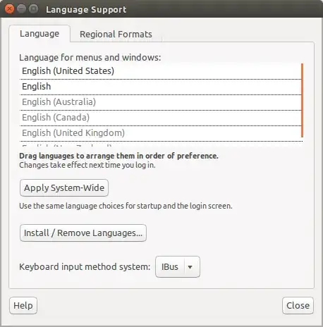

Open Language support from the dash:
langsupport

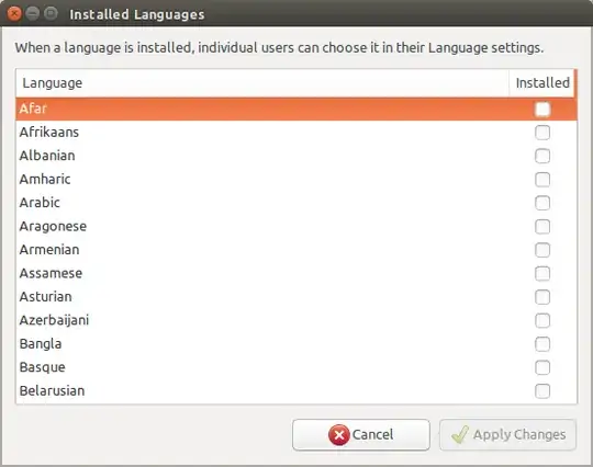

Click install/remove languages.

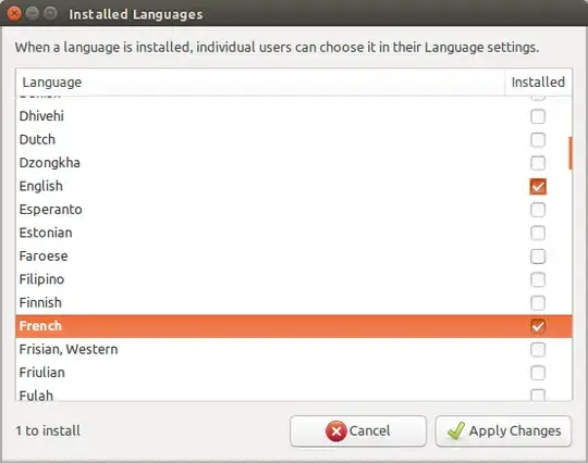

Scroll to the language you wish to install, tick the box and click apply changes.
Support for your chosen language will be installed:

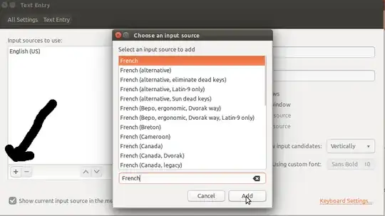

Now that you've installed the language in your system, each user (this means you) can select it as an option in text entry settings as shown below:
text entry
Hit the + button to bring up the menu as shown below:
AddFrench
Now you can select French as a text entry language.
SelectFrench
