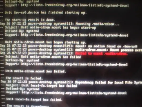

The output of journalctl -xb is as follows
text including failed to mount /media/cdrom in red
Where it is in red color I think it is the cause for the emergency mode.

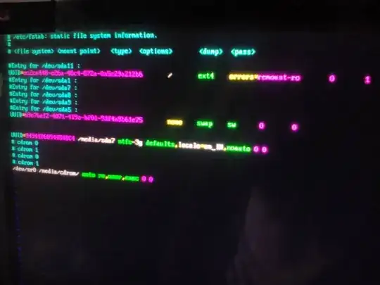

The output of cat /etc/fstab is as follows:
fstab contents with syntax highlighting - appears to be vim, not output of cat file as stated

This happen because your system, for some reason, attached /dev/sr0 to the /etc/fstab file. You need to disable this entry.
  • Boot your computer by recovery mode and go to root option;
  • type mount -o remount, rw / to allow write-permissions to / folder;
  • Edit /etc/fstab and comment line that references to /dev/sr0;
  • Save this file and reboot your system.
