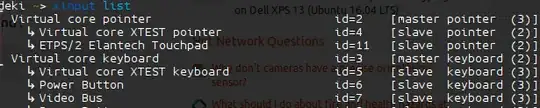

for disable and enable touchpad, first see id of your touchpad using this command :
xinput list
this exmaple for the output , and look ad the id of your touchpad : enter image description here

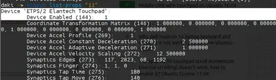

xinput list-props "your-touchpad-id"
this output for my touchpad
and finally , you can disable your touchpad using this command :
xinput set-prop "your-touchpad-id" "Device Enabled" 0
and this command if you want enable the touchpad :
xinput set-prop "your-touchpad-id" "Device Enabled" 1
