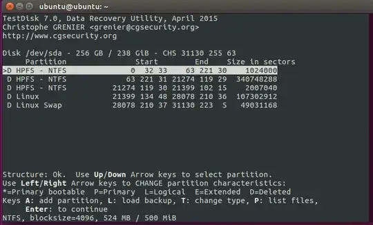

UPDATE 2 Now going through testdisk, here's the latest output enter image description here
http://paste.ubuntu.com/25572230/

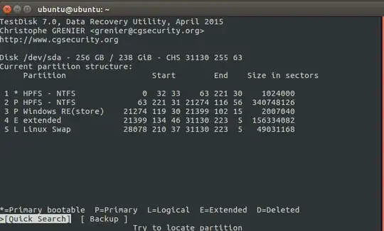

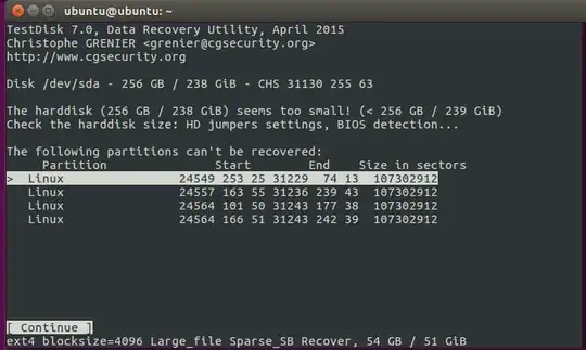

UPDATE 3 Performed the quick scan, my files are seemingly there.. but when I do the deep scan I get this warning
Leaving everything marked for deletion.. in my experience I need to select the partition with the boot file in the root dir to be bootable, and unmark for deletion all the rest...

Windows 10 Anniversary Update, and the more recent Windows 10 Creators Update, have a really bad habit of wiping out Linux partitions on MBR disks. Sounds like you're a victim.
Recovery is possible, but it can be tricky.
Boot to the Ubuntu Live DVD/USB.
Open Software & Updates and make sure that all of your software repositories are enabled.
In terminal...
sudo apt-get update # update the software database
sudo apt-get install testdisk # install testdisk
man testdisk # read the manual
sudo testdisk # start testdisk
You can also get specific instructions here: http://www.cgsecurity.org/wiki/TestDisk_Step_By_Step

From the link you posted, it seems that the win10 upgrade repartitions the HDD and deletes non windows partitions.
So before you can do the grub repair steps that you found, you have to recover the deleted linux partitions.
Boot from a liveCD or USB and install testdisk.
