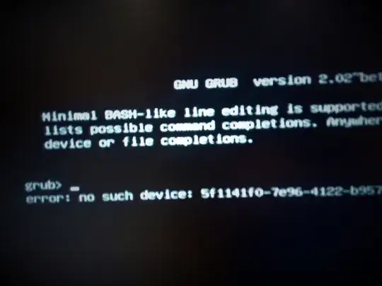

After upgrading I got this screen on booting:
First Grub screen
I did some googling and this seemed to be an answer with plenty of upvotes so I tried
bcdedit /set {bootmgr} path \EFI\ubuntu\grubx64.efi

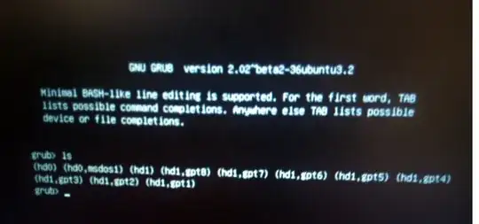

However on the next reboot I got the same screen. When I tried exit I got another Grub screen but with an error:
Second Grub error
After doing exit twice on this screen it started booting into Windows.

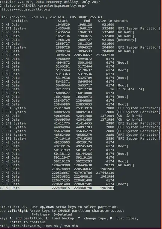

Update: I've tried running TestDisk and after a deep scan get this result:
testdisk result
I tried to list the files on the the partitions with the largest sectors, one of them shows a Windows filesystem, the other says "Can't open filesystem. Filesystem seems damaged."
