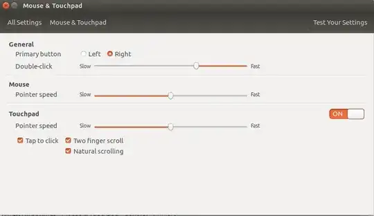

I'm using Dell Vostro 3568 model, recently installed ubuntu 17.04. My touch-pad left and right click working same way.
If left radio button selected in my settings( All Settings->Mouse & Touchpad->General->Primary button) then left and right click behaving like left click always no matter even I clicked left or right.
If right radio button selected in my settings( All Settings->Mouse & Touchpad->General->Primary button) then left and right click behaving like Right click always no matter even I clicked left or right.
Can some one help me to get this fixed, please?? Thanks in advance.
Left settings
Right settings
