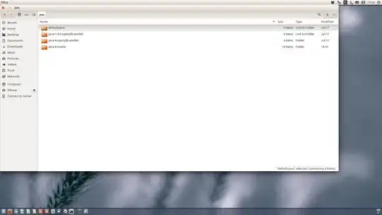

I am following this How to set JAVA_HOME for Java? in order to set the environment variable JAVA_HOME to the correct version. I have different versions of java in my /usr/lib/jvm/folder as illustrated in the following picture.
