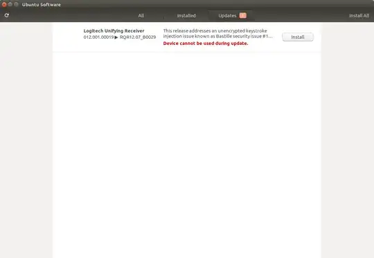

There's security update for the Logitech Unifying Receiver (see Screenshot).
Ubuntu Software Screenshot
Clicking the button does nothing.
