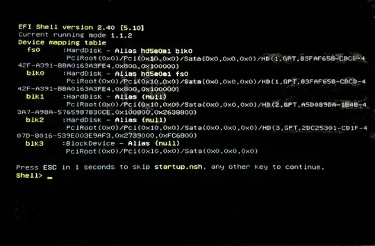

I am trying to install Ubuntu on a single board computer. I booted from a USB drive with the correct image on there and went through the menus that installed Ubuntu. Once the computer restarted I unplugged the USB drive and got the following menu:
EFI Menu After Ubuntu Installation
I don't know why it's not booting into Ubuntu itself and if I try to restart the installation process the Ubuntu installer recognizes that there is an existing installation. Based on the limited research I've done online, I think I need to do something to the partitions, although I'm not sure what or why.

As a temporary workaround, try typing these commands at the EFI shell (the Shell> prompt in your image):
fs0:
cd EFI\ubuntu
shimx64.efi
This sequence should launch GRUB, which in turn should launch Ubuntu. There are a number of reasons why this might fail, but chances are good that it will work.
Once Ubuntu is booting, run the Boot Repair utility and select the "Create BootInfo Summary" option. (DO NOT click "Recommended Repair," at least not yet!) When asked whether to upload the report, click "Yes," and then post the URL provided here. This will give us more details about your configuration, which is required to base a more permanent answer on more than guesswork.
If you can't get Ubuntu to boot using my workaround, you can run Boot Repair from the Ubuntu installer booted into its "try before installing" mode.

In my case with ArchLinux first I just had to enter
mount fs0
Then
fs0:
cd EFI\ubuntu
shimx64.efi
Solved it.
Thanks!!
Thanks, I have the same issue(on a Dell Chromebook 13 7310) and your response has finally gotten me into ubuntu, you rock.
only issue is that after reboot it repeats the problem. options to add flags in the "Boot Repair" utility weren't available.
here is the info. http://paste.ubuntu.com/26262059/
After some google searching I found a response that made the solution permanent via copying a file. some explanation would be nice on this workaround as it's not very clear to me how it worked. https://askubuntu.com/a/906821/310848
thanks again for all your help :)
