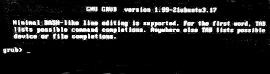

I've been using Ubuntu 12.04 normally, but today when I turned my laptop on, and selected Ubuntu out of two options: Windows and Ubuntu, the following screen appeared:
I searched this a lot on here, but couldn't find a working solution.
One solution suggested me that I should do first ls in different partitions and see where the file vmliuz or initrd resides. But I found no where these files.
I also played with the brightness of my laptop, which may be a cause of this stuck screen.
Edit 1:
I'm still unable to find the directory that contains the initrd.img file.
grub> ls
(memdisk) (hd0) (hd0,msdos3) (hd0,msdos2) (hd0,msdos1)
grub> set pager=1
grub> ls (memdisk)/
wubuilder.cfg
grub> ls (hd0)/
error: unknown filesystem.
grub> ls (hd0,3)/
$AttrDef $BadClus $Bitmap $Boot $Extend/ $LogFile $MFT $MFTMirr $RECYCLE.BIN/ $Secure $UpCase $Volume ./ Code School/ Downloads/ Movies/ System Volume Information/ ubuntu/ wubuilder
grub> ls (hd0, 2)/
Programming Files (x86)/ Users/ $AttrDef $BadClus $Bitmap $Boot $Extend/ $LogFile $MFT $MFTMirr $RECYCLE.BIN/ $Secure $UpCase $Volume ./ Documents and Settings/ hiberfil.sys Intel/ MSOCache/ pagefile.sys PerfLogs/ Program Files/ ProgramDAta/ Recovery/ Setup/ swsetup/ System Volume Information/ Windows/ wubildr wubildr.mbr
grub> ls (hd0, 1)/
$AttrDef $BadClus $Bitmap $Boot $Extend/ $LogFile $MFT $MFTMirr $RECYCLE.BIN/ $Secure $UpCase $Volume ./ Boot/ bootmgr BOOTSECT.BAK System Volume Information/
Edit 2:
Also, please note that I've installed Ubuntu 12.04 and Windows 7. And my Ubuntu resides at the following location; I checked it by booting up Windows OS:
grub ls (hd0,3)/ubuntu/
install/ uninstall-wubi.exe winboot/

If you have installed without Wubi.exe:
At the grub prompt try these commands:
set pager=1
ls
Now, suppose the output of ls is: (hd0) (hd0,msdos2) (hd0,msdos1), in order to find the linux root filesystem run:
ls (hd0,1)/ which should give you all the files/folders in / such as bin/ boot/ cdrom/ dev/ etc/ home/ lib/ etc.
Once this is done continue with:
set root=(hd0,1)
linux /boot/vmlinuz-3.13.0-29-generic root=/dev/sda1
initrd /boot/initrd.img-3.13.0-29-generic
boot
Of course replace vmlinuz-3.13.0-29-generic and initrd.img-3.13.0-29-generic with what you find in your /boot
/dev/sda1 is the location of the root system. You may have to change it if /dev/sda1 did not work.
If you have installed using Wubi.exe:
If you have installed Ubuntu using Wubi, perform following steps as given in the WubiGuide:
  1. boot into Windows, run chkdsk /r from Windows on the same drive where you installed Ubuntu, shutdown cleanly and then try to boot into Ubuntu again.
  2. if still not good, check that you have a C:\ubuntu\disks\root.disk file. If this file is missing, boot on Windows, open the Windows Explorer, set it to be able to see hidden folders, then look for a hidden folder called C:\found.000 or dir0000.chk . Move the files from found.000 to their original location inside the \ubuntu\disks directory. You may have to rename it into root.disk.
Ron
  • 20,938
14
Run those commands
grub> linux  (hd0,1)/vmlinuz root=/dev/sda1
grub> initrd  (hd0,1)/initrd.img
grub> boot
Replace hd0 with your hdd number and /dev/sda1 with your partition holding the /boot mainly the dafult will work if you don't have more than one hdd and with default installtion
check this for more info
When you can boot again you should fix your problem
sudo update-grub
sudo grub-install /dev/sda
