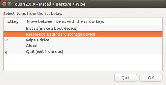

There is a straight-forward alternative, when there is nothing important, that you must keep or recover on the USB drive. Wipe the first mibibyte, create a new partition table and file system.
Use mkusb and select Restore to a standard storage device.
If mkusb does not solve the problem, the USB drive may be damaged. But there may be other problems too, so please try according to the following list,
  • On some pendrives and on many memory cards there is a small mechanical switch for write protection, that can toggle between read/write and read-only. You might have set it read-only without intention.
  • Reboot the computer and try again to restore or wipe the first megabyte with mkusb.
  • Disconnect other USB devices. Sometimes USB devices can disturb the function for each other.
  • Try other USB ports and another computer.
  • Try another operating system (Windows, MacOS) in another computer.
  • If you still cannot wipe the first megabyte of the drive, and the drive is read-only, it is probably 'gridlocked', and the next stage is that it will be completely 'bricked'. There is a limit, when you have to accept that the pendrive is damaged beyond repair, at least with tools available to normal users like you and me. See this link: Pendrive lifetime
See this link for more details,
