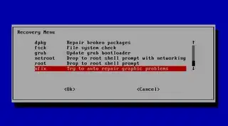

As Ubuntu is very reliant on internet, I am currently investigating how to connect to internet when choosing recovery mode. Even in my healthy 11.10 system it doesnt work (nor wireless, nor wired). I ticked for both cases available for all users.
Normally, in recovery mode the netroot option should give you access to the internet, but no joy. Any idea?

When you boot to recovery mode you should get an option to drop to a root shell with networking , netroot
netroot
I do not know what problem you are having, but sometimes it is easier to use the live CD.
https://help.ubuntu.com/community/LiveCdRecovery
If needed you can use chroot to access / update your root partition.
Assuming your ubuntu partition is as /dev/sda1 (you may need to mount /home and/or /boot if you have separate /home or /boot partitions) ...
sudo mount /dev/sda1 /mnt
# If needed
sudo mount /dev/sda2 /mnt/boot
sudo cp /etc/resolv.conf /mnt/etc/
sudo cp /etc/hosts mnt/etc/
sudo mount --bind /dev/ /mnt/dev
sudo chroot /mnt
mount -t proc none /proc
mount -t sysfs none /sys
mount -t devpts none /dev/pts
You should now have root access to your ubuntu root partition.
