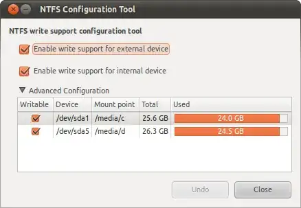

The "problem" is that Windows can not use ext4 (ubuntu) partitions easily.
My advices would be to mounting your windows partition in Ubuntu and save your documents on your windows drive in your home folder.
You can configure the windows partition to mount with a graphical tool, ntfs-config
sudo apt-get install ntfs-config
Then run it with gksu
gksu ntfs-config
ntfs-config
Alternately your can save your documents to a shared device such as a flash drive, or make a separate shared data partition.
See Ubuntu wiki mount windows partition for details.
