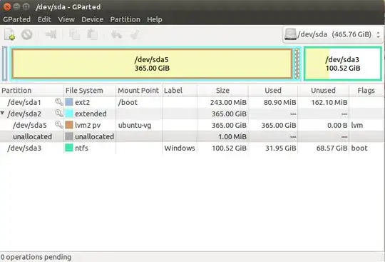

I have recently installed Windows (10) on my Ubuntu (14.04) alongside after shrinking the root partition ( /dev/ubuntu-vg/root ) using GParted live (terminal) and rearranging the partitions using GParetd Partition Editor (GUI).
But now I cannot access root partition from Windows using Ext2Fsd. Here is my partition list.
/dev/ubuntu-vg/root is not in the Partition list and I think it is some where inside the /dev/sda5. Ext2Fsd identifies the file-system of this partition as RAW.
Please let me know if there is a way to access this Partition from Windows 10.
