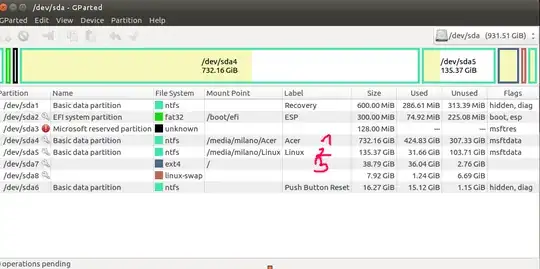

I have a problem on my Ubuntu 16.04. I've created a two partitions before installing Ubuntu. One is 40 GB (nr. 3) and second is about 150 GB (nr. 2). I thought that 40GB is for Ubuntu installation enough because I didn't know that many things are installed to this partition.
So now I have a problem. When I install for example Bytecoin wallet, there is ~/.bytecoin/ created which takes a lot of disk space. Many other programs uses this partition and I don't have a disk space anymore there.
I could resize partition 2 to for example 35 GB and then resize 3 to 138 GB but I'm not sure if it's safe since the root is on partition 3.
I can just click on the partition and resize it.
Is it save? Or do you have another way to solve this problem?

You can resize the root partition like described in this SO answer.
But another, maybe easier way is:
Create a new partition and create a symlink to it. In your case
and create a new partition in the free space, e.g. named /dev/sda9. Then format it with ext4, create a directory bytecoin/ on it and move all data from ~/.bytecoin/ on your old partition to bytecoin/ on the new partition. Finally remove the old folder and create a soft-link in its place
ln -s /dev/sda9/bytecoin ~/.bytecoin/
The philosophy behind this is to differentiate programs from data.
