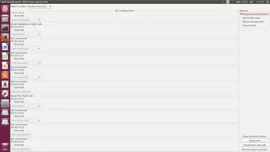

In the application I ticked show unconnected pins and attempted to use trial and error to find a working combination. I had the B/O front firing speakers working through overriding and setting all pins as internal speakers, but could not find a working configuration for the subwoofer. Can anyone suggest a suitable configuration?
I'm using Ubuntu 17.04.
Screamshot for HDAJackRetask GUI config for my pc
