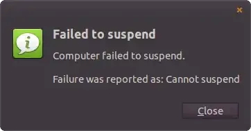

  • The suspend and hibernate options disappeared from the shutdown menu. If I press my keyboard's suspend button (or if I close the lid) I get the following message: alt text
