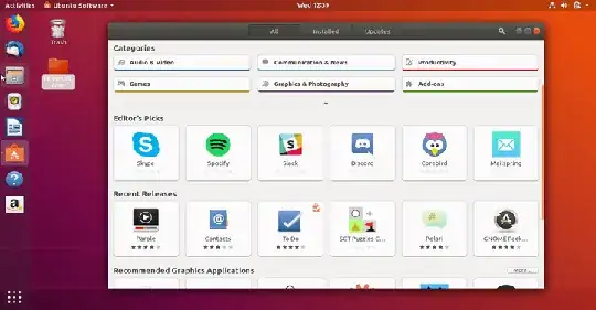

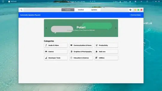

This is not a problem with your Software Center or your Shell. Actually, the interface of the Software center keeps changing automatically. This is my current interface of the Software Center
A few weeks ago, it was like this.
