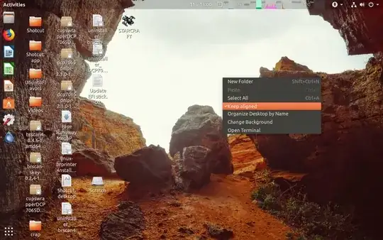

With Ubuntu 18.04 Right-click on the desktop and select Keep aligned as shown below:
Be aware that if there are holes in the grid due to icons that you have deleted they will be filled first.
