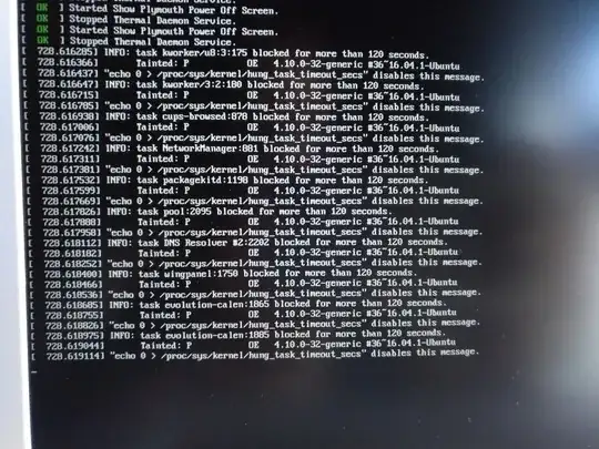

Today ago 16 I have experienced the freeze lots of times. When freezing, no text is shown in the screen if I press ESC, but if I press the power buttom then the elementary symbol appears in screen (as in the booting), and if I press ESC there, then I obtain some text:
UPDATE 2: After another freeze (and turning the laptop off with the power button), I start the laptop and I get a error message related to the suspend:Elementary  has experienced an internal error
Minkowski
