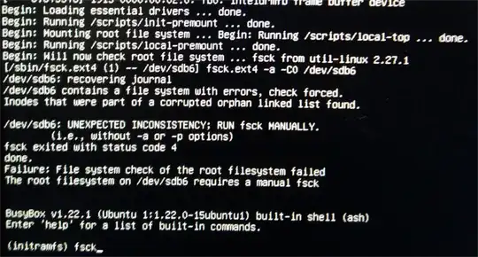

I googled what happened and found almost nothing, so it would seem that I've run into something strange. I rebooted my computer, but it got stuck in the following state:
boot screen
I then run fsck /dev/sdb6 (this is were / is installed) and I got asked a lot of questions, and answered yes to all of them. I then rebooted again and now everything seems to be going ok.

It's been a year since this incident. I kept using using the same Ubuntu 16.04 (without reformatting). At least I can say that I've not had this problem again. So, if anyone is panicking at this as I did a year ago, there is a chance that a single fsck /dev/sdb6 will solve the issue and you will not run into it again.
