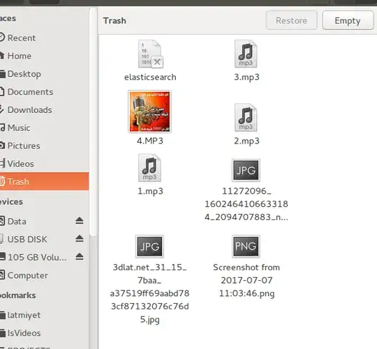

How to restore a file from the trash using command line?
Obviously you can use restore-trash command from the trash-cli package, but this wouldn't list all files inside the trash.
Moreover what about files moved to trash with root permission?
Those are files in trash: enter image description here
Now using restore-trash command: enter image description here
only 4 files are shown.

If you run trash-restore from within a directory, It will only show the trashed files and directories that were trashed from the current directory or its sub-directories
As it appears, you are running trash-restore from your home directory. So, it is only showing files and directories that were trashed from your home directory or its sub-directories.
To restore files trashed from another directory, for example /var, you would need to cd to the /var directory first and then run trash-restore from there.
Alternatively, you can specify the system root directory / after trash-restore like so trash-restore / to make it show all trashed files and directories originating from anywhere in the system.
