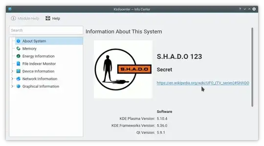

Example S.H.A.D.O ($HOME/.config/kcm-about-distrorc as the users configuration files take precedence over system entries of /etc/xdg/kcm-about-distrorc)
[General]
Name=S.H.A.D.O
LogoPath=/usr/share/about-distro/SHADO-logo.png
Website=https://en.wikipedia.org/wiki/UFO_(TV_series)#SHADO
Version=123
Variant=Secret
KInfocenter will show:
