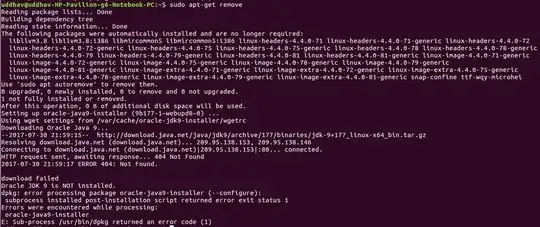

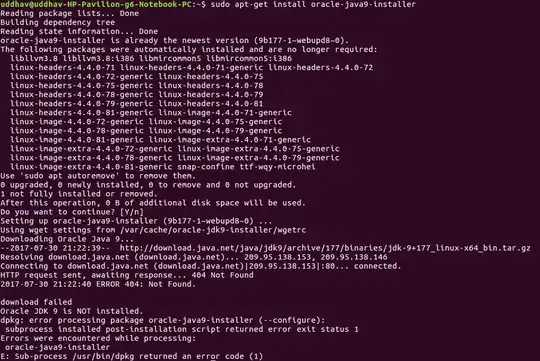

When I do sudo apt-get install oracle-java9-installer I get the error shown in below picture.

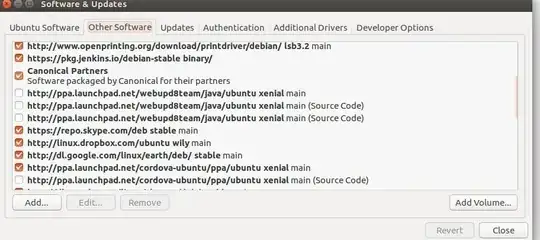

I removed oracle-java9 related ppa sources file from /etc/apt/sources.list.d, and also removed oracle-jdk9-installer folder from /etc/apt and removed oracle-java9 related packages from /var/cache/apt/archives.
I have not selected any java related ppa sources in my sources.list file.
Every time I try to install/remove/configure something, I get error of JKD9 aso shown below. And the folder oracle-jdk9-installer that I removed in the past from /var/cache again appears.
Because of this incomplete installation of JDK9, I can't install/remove/configure anything in my Ubuntu 16.04 system.

After researching sometime in the internet, I found that I can install JDK9 using sudo apt-get -o Dpkg::Options::="--force-overwrite" install openjdk-9-jdk. I ran this script, but still I get the error as presented below picture.
