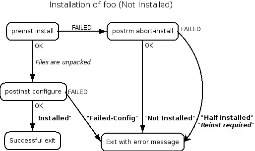

There is an interesting picture, showing the procedure of an installation of a new package:
installation
