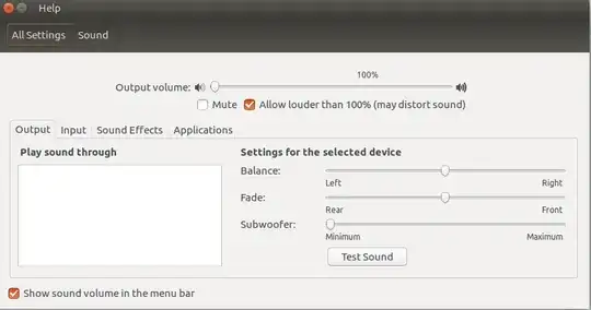

PulseAudio not working in my Ubuntu 16.04 LTS.
Hardware: Laptop Toshiba A665 8 GB Ram
When I open the sound settings there is not a device to output or input the sound.
pulseAudio not found, no audio devices
