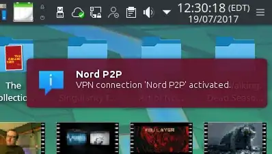

I just installed the Ubuntu desktop environment (Unity), and now I'm getting Ubuntu style notifications in KDE. I don't really like this in Plasma, so how can I revert to the Kubuntu style notifications without uninstalling Unity?
Edit 0: This might have something to do with me switching my layout to lightdm, but I'm not certain.
Ubuntu Style Notifications
