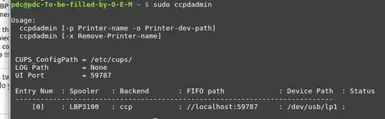

enter image description herethe command sudo ccpdadmin asks for the status of the ccpdadmin so please see how ours appears: we have 2 usb printers: the first is allocated to /usb/lp0 and the second, the LBP, is allocated to /usb/lp1 and if you have 2 printers on your usb, then if the LBP6000 is the second in the rankings, then it needs to be lp1
