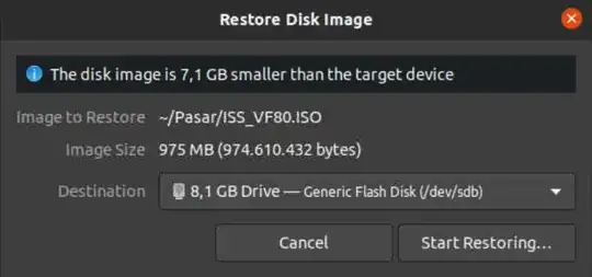

One way to do this very simple in Ubuntu 20 is:
Right click over your .iso file. Open with other application. Select Disk Image Writer Open with Disk Image Writer.
When ask to restore Disk Image, select your USB target
Restore ISO to USB Click on Start Restoring.
And that should be all!!.
