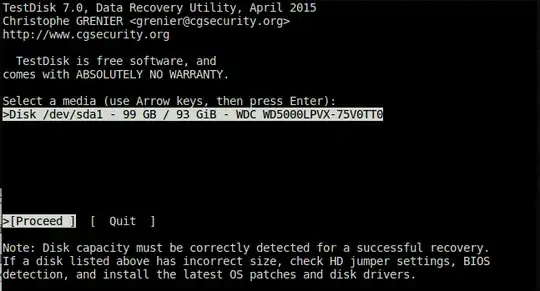

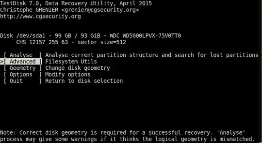

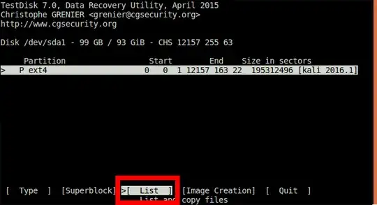

2. testdisk
This is a bit more interactive and works exceptionally well with freshly deleted files and directories - and has the added benefit of working with virtually all ubiquitous filesystem and partitioning architectures. Again, if you already have the package in your distro, go on to the recovery portion of this text. However, if you don't, install it by sudo apt-get install testdisk. The first step in the recovery process is creating an output directory for the recovered files and directories. To do this use
mkdir /mnt/windows_8/REC
Then in a root shell, open testdisk as,
sudo testdisk /dev/sda1
This will open an interactive CLI window. Press Enter to Proceed. Then select None to declare the disk as a non-partitioned media. Press enter to move to the next page. The choose Advanced. Then Press to highlight List and press Enter. This will list the contents of the /dev/sda1 partition and you can navigate the program's window by following the Help info at the bottom and top of the screen and easily recover your files. In testdisk, deleted files and directories appear in red. Use the directory you created earlier i.e. /mnt/windows_8/REC to output the recovered files.
Both of these methods work better on freshly deleted partitions and filesystems. The more you wait to shutdown your system after inadvertently deleting a file or a system, the more likely is the chance of losing the files/directories for good.
