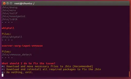

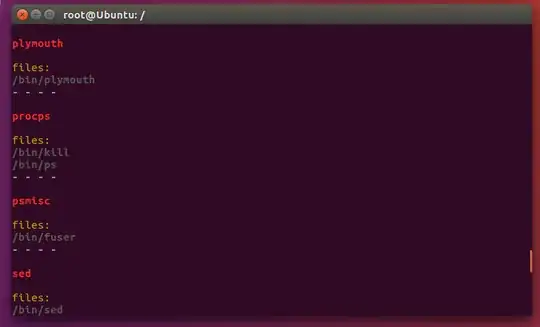

So I wrote a script which does everything we need. It finds all necessary packages for us to restore /bin, shows us the name of each package and their related files that belongs to /bin. Here is a screenshot:
Screenshot of <code>/bin</code> package list as output by my script
At the end we choose to reinstall all packages or only download and extract the necessary files to /bin (which is the recommended option):
Screenshot of options given by my script
You can grab a copy of this script or download it directly.
