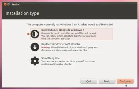

It is significantly easier to install Ubuntu after installing Windows. The Windows installation process has no option for installation alongside another operating system, so doing so involves manually resizing partitions and fiddling with your master boot record. While this is certainly doable, the process is less "on rails" and leaves more room for user error.
Installing Ubuntu second is as simple as the following screen:
Screenshot of Ubuntu Installation "Installation Type" section
