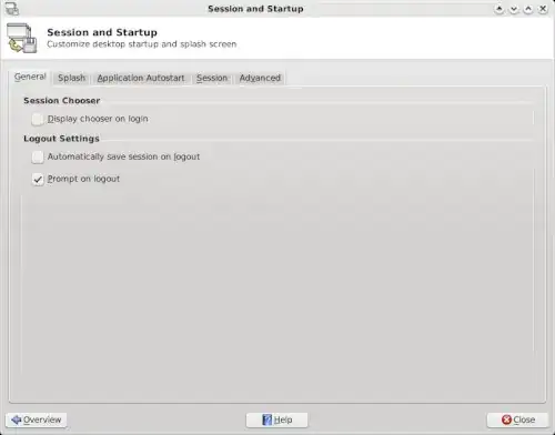

In the XFCE settings, go to "Session and Startup"
In the general tab, unselect "Automatically save session on logout"

Remove previous saved session (with GUI):
Press "Clear saved session"
