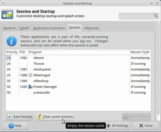

Ok it look like gimp is saved in your session cache.
.cache/sessions/xfwm4-23e853443-fb4b-42fd-aa61-33fa99fdc12c.state
.cache/sessions/xfce4-session-athena:0
Try this:
Press "Clear saved session"
Then be sure gimp is not open and restart.
