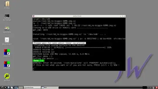

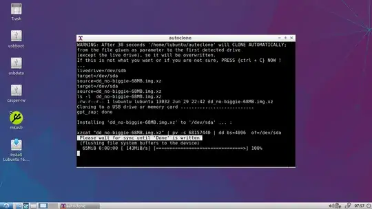

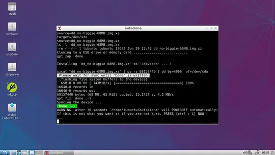

Screenshots
Three screenshots of Lubuntu
During the first 30 seconds you can use the hotkey combination ctrl + C to stop autocloning,
Console output: at this stage the system is syncing (flushing the buffers to the target drive),
During 30 seconds you can use the hotkey combination ctrl + C to avoid poweroff (if you wish to stay in the Lubuntu desktop session),
A corresponding screenshot of 9w
