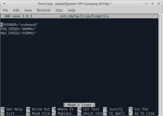

I'm on Xubuntu 18.04.02 LTS and installing cpufrequtils by sudo apt-get install cpufrequtils, made it possible to reduce the max CPU-speed. A nice option to have as the fan has stopped working.
After looking at the info by cpufreq-info, I created a file by sudo nano /etc/default/cpufrequtils, and wrote into it as in picture below. I found out it was of use to also set a value for min speed.
Lastly the command to make the change take action sudo /etc/init.d/cpufrequtils restart, resulting in this output from cpufreq-info:
