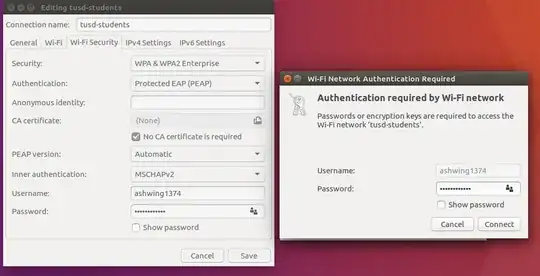

The following shows the settings and the message that keeps coming up: enter image description here

I've read in many places that adding system-ca-certs=false fixes it, but that didn't work. I also tried adding the domain Domain\username but that didn't work. I've tried everything here and in many other posts. Not sure what to do, I'm new to Linux. Any help is greatly apreciated, if there is some other info I should include please let me know. Thanks!
