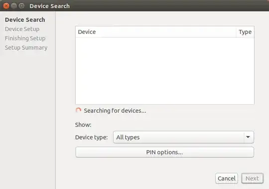

My Ubuntu 16.04 WiFi is not getting connected to my Bluetooth speaker. Even when I try searching for the new device it is not showing anything though the speaker gets connected to my smartphone. My smartphone also doesn't show my laptop's Bluetooth though the visibility is on.
I have checked blockage, it says no.

Also on restarting the bluetooth, it shuts off but does not start.
It's Ubuntu 16.04 LTS.
