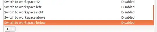

Check your system keyboard shortcuts:
Go to : System Settings -> Keyboard -> Shortcut Tab
Then you can disable any shortcut you want :)
