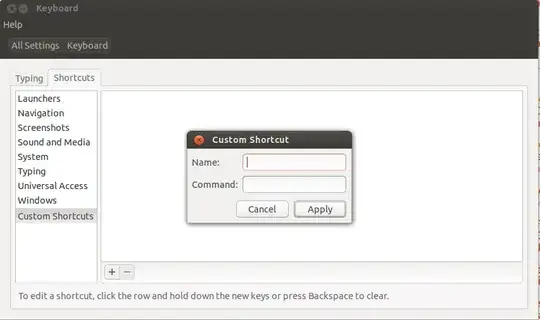

Instead of using Ctrl + Alt + T as the shortcut, you can redefine Alt + T as the shortcut in the Settings > Keyboard > Launchers settings to replace the old Launch setting for Launch terminal (this is not to set up a new customized short key). It seems a bug and may also because there is a conflict. This works for me at least.
Xiaodong Qi
  • 2,562
-3
Go Settings->Keyboard->Custom Shortcuts
